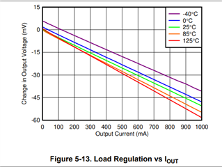

Hi Team,
The datasheet only provides the data Iout= 1mA.
and Figure 5-13. Load Regulation vs IOUT, shows that the output change @750mA about 40mV,  when output is 1V, the best expected accuracy would be 40/1000=4%.
1.So how can I understand the accuracy at the condition "Vout=1V Iout=750mA @ 85°C"? , can the accuracy be within +-1%?
2.Could you please help to provide the accuracy data at this condition? Can we got it from the datasheet or we have to ask from the product line?
B.R.
Eric

  • Hi Eric,
    The spec conditions were taken at 1mA. The load regulation graph that you are seeing is up to 1A, which is not what the 1% was specified for.
    We are unable to provide you accuracy data for the condition you specified. The conditions we can provide are in the datasheet.
    All other conditions we cannot guarantee accuracy.
    Hannah
