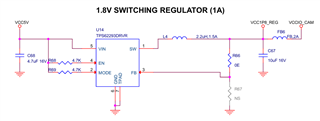

We are using TPS62293DRVR part on our power regulator section of the product. For your information, Vin = 5V, output voltage = 1V8, maximum load current requirement = 500mA. we have received customer complaint and take the boards for analysis, and observed the TPS62293DRVR input and output section shows short. Pin1-Pin6 = 2ohms short and Pin5-Pin6 = 50ohms short observed.
Is there any possible to share the probable cause of the IC short.

    The Vin to GND and SW to GND shorts indicate the internal high and low side power FETs are damaged. The are typically damaged when there are input voltage spikes above the ABS max ratings of the device.
    Could you monitor the input voltage to the TPS62293 to see if there are any spikes during certain application conditions?
    What is the failure rate? How long have the devices been in the field before failure?
    If possible could you share the schematic and layout?
    Varun
    Comments: We have verified the components input and output and we doesn't observed any spikes during the functional process in another working cameras.
    Comments: we have received a complaint on only one camera and customer is reported on out of box failure.

    In further, if you required the sample. we will ship the sample to you for analysis. we would required the probable cause for the failure. It will help to lead the analysis for further process.

    The reason for these kind of failures is typically VIN spikes. It may be difficult to catch / reproduce them. A damped LC filter on the input can be added to filter out the spikes. Please refer to this app note on how to design a filter https://www.ti.com/lit/an/slvafe0/slvafe0.pdf
