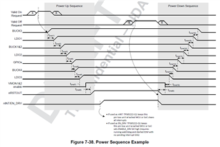

Can I get a TPS6522311-Q1 Power sequence ?
On datasheet, TI doesn't comment time of power sequence.

Hi Jihoon,
you can find the user's guide for TPS6522311-Q1 in secure resources. If you don't have access yet you can request it here.
