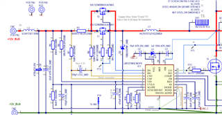

Dear team,
We have designed a boost inverter using "LM5121MHE". In case of having short circuit at the output I expect the NMOS T1 (As you see in the following photo) to open and shorten the input voltgae. But it seems that when there is a shortcircuit at the output, it just doesn't boost the voltage and I see the input voltage at the output. There is sth with this functionality (DG) that I don't understand. Can you take a look at the SCH and let me know if sth is wrong there?
Input: voltage 12V
          Current 7A
Output: voltage 48V
          Current 1.4A
Thanks in advanced

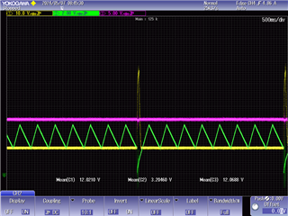

  • Dear Harry,
    The first Photo is the circuit without zener, as you explained me before and by the datasheet I undertood that it should enter to hiccup mode if I put a zener in parallel with the Res capacitor. I don't have the zener and still it's in hiccup mode:
    Pink probe: input voltage 12V
    Yellow probe: output voltage 48V
    green probe:Res capacitor
    We removed the RES Capacitor  to connect the RES pin directly to GND and this photo shows the result:
    In this photo it seems that the chip regulates the voltage. As we increase the output current it decreases the output voltage and the power consumption remains constant.
    by the way I tested T1 and T2 as you have mentioned, they are OK.

  • Hello Farzaneh,
    Thanks for the Oscilloscope screenshots.
    The first image shows that the fundamental hiccup procedure works.
    After eight triangles of the RES voltage, the controller is starting over, resets the RES voltage and tries boosting.
    But due to the overcurrent, the voltage on the RES pin exceeds the threshold and another eight triangles will start.
    The one thing that does not work is that the breaker transistors do not turn off.
    PLEASE DO NOT CONNECT THE RES PIN TO GND.
    This will probably damage the internal current source.

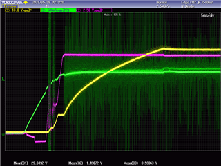

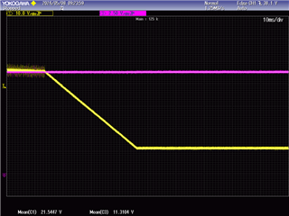

  • Morning Harry,
    I cheched the T1 and T2 as you have explained me. I removed R5 and I didn't observe any voltage at the output. So according to your explanations if it is so, it means that they are OK. Placing back R5 I observed 48V at the out put. By the way I changed the PCB and I took a new one to descart any damaged cuased by testing.
    Following you can see the screenshots of what you asked for:
    starting up:
    Yellow probe :Output
    Green probe : UVLO
    Pink probe : DG-DS (differential probe)
    Connecting load:

  • Hello Farzaneh,
    Thanks for the additional screenshots.
    The inrush current limiter also works fine and the breaker FETs are controlled correctly at that time.
    So, I assume the following:
    The overcurrent that you apply is not high enough that it would (permanently) exceed the circuit breaker threshold:
    VCS-TH3 Circuit breaker enable threshold CSP to CSN, Rising: 170 mV (max)
    If the voltage drop on the sense resistor does not exceed 170mV, the breaker will stay ON.
    The hiccup mechanism is independent and even if the breaker is not tuning off, it will show these 8 cycles, as seen in your previous screenshots.

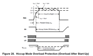

  • Morning, Harry,
    I wanted to express my gratitude once again for your invaluable support and thorough explanations. Thanks to your guidance, we've finally managed to decipher what was causing the issue. It seems there was a misinterpretation of the datasheet on our end.
    Upon closer inspection of the attached photos extracted from the datasheet:
    We initially concluded that both overcurrent and short circuit instances would trigger T1 and T2 to open, thereby cutting off the output. However, our observations have revealed a discrepancy. While a short circuit does indeed result in an output voltage of "0," in the case of overcurrent, we're perplexed to find that the input voltage persists at the output.
    It appears you were correct in your assessment that we weren't subjecting the system to sufficient current to observe the expected output voltage drop to "0."
    Thank you once more for your patience and guidance in navigating this issue.
    Farzaneh
  • Hello Farzaneh,
    Thank you for the feedback.
    I understand that especially the second image might suggest that all the shown signals would always happen in this combination and that the word "overload" is not clearly defined.
    Only the Electrical Characteristics table will tell you that the circuit breaker uses a different / higher threshold.
