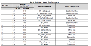

    For the voltage reduction, you can use this table:
    Just multiply 3.3V * [(DIV_MIN + DIV_MAX) / 2] to get the required voltage for the voltage divider.
