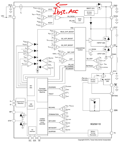

    2. For OTG mode in this post I figured the output is at Vbus, so Ibst_acc would be this current in the screenshot shown below?
    Thank you!
  • Hi Ryan,
    1. Yes it would be the 6A to the system.
    2. Yes that is correct.
