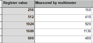

We have some issues related to setup the charging current, the real charging current is less than what we set.
We use 3s battery.

Another problem we have is the charging not working in boost mode when the input voltage is less than 12.6V(or less) it stops charging. Do you have any ideas why it is happening?
Thank you, Alex.
