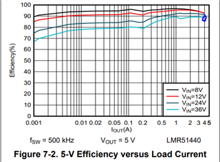

Hi Alex
I don't have any boards to test (I ordered them, they should arrive in a week).
The part is ~88% efficient at that condition:
In that state the chip is heating up because of about ~2.4W of losses. That seems reasonable on the Eval board. In a real application you can improve this by having a larger PCB board area. This lets there be more copper to cool the board.
