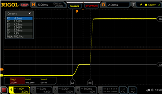

When the device works, I can see this waveform:
And when it does not work, the ouput directly is not activated and remains to ~1,2V. The first little step to 1,2V is when the system is energyzed, but eFuse still off, and then when eFuse is activated, the output reaches the 6V.

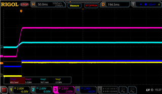

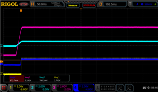

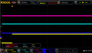

  • Hey Arush,
    I could do the test you requested. Here are the oscilloscope output of all the signals:
    CH1: EN                     CH2: OVLO                CH3: VIN                       CH4: VOUT
    As you can see here, now, the output is not enabled. I could catch the actual problem I'm facing.
    VIN is always before the output voltage is applied. Here you can see the startup sequence:
    VOVLO < 1,2V
    VEN > 1,27V
    VIN ~ 6V
    In this scenario, as you can see, even a rising edge in EN pin does not enable the output, neither at the startup or after the startup (1st graph).

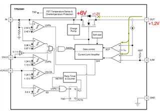

  • Checking block diagram of the device, the only path I can see for the currento to flow from the output is this one:
    Could be possible that some input current over there can make the device to hang when it's not enabled?

  • Also, we shouldn't see the reverse current flow through any internal paths other than body diode which is correctly biased in your case so no reverse current should flow.

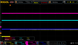

  • I did the change, and put the ILIM resistor to 26K (~2A of limit) and same result. If I bypass the eFuse and use a multimeter to measure the current consumption of the external device is about 17mA, so far from the ILIM set. Here are the results, both, during startup and after doing an enable when device has already started.
    Startup:
    Enable:
