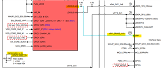

on document which is "J722S/AM67x/TDA4VEN/TDA4AEN Processor Automotive Power Designs using TPS6522312-Q1 PMIC"
If we set RS0 to GND, is it right LDO2 is for SD Card supply?
I understood
 1) RS0: 0 set -> LDO2 for SD Card
 2) RS0: 1 set -> LDO2 for efuse supply
but below power map is vice versa.
which setting is correct, if we want to use LDO2 for Efuse Prgm?
best regards,

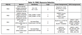

  • Hi Jihoon,
    Thank you for reporting this mistake. I will communicate this to the engineer responsible of this document. The table 10 information is incorrect so you can follow this guide:
     1) RS0: 0 set -> LDO2 for efuse supply
     2) RS0: 1 set -> LDO2 for SD Card
    I also confirmed this functionality on our EVM.
