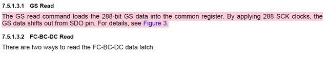

Could you please explain the process of reading status information data (SID) from the TLC6C5716-Q1 device with command code '5A3' in a daisy-chain configuration? Specifically, how do I initiate the read operation from the device to the microcontroller, and what steps are involved in retrieving the SID data once the command code is sent.
Command Type Condition Register Affected
FC-BC-DC Write LATCH high at 288th SCK rising edge & 12 MSBs of data = 0 Function Control (FC), Brightness Control (BC), Dot Correction (DC)
GS Data Write LATCH low at 288th SCK rising edge Grayscale (GS) Configuration Registers
Special Commands LATCH high at 288th SCK rising edge & 12 MSBs match any of eight 12-bit command codes Executes corresponding command
i dont understand this line , it also in page number 32
As it follow  daisy-chain configuration, how it will work?Could explain too.
