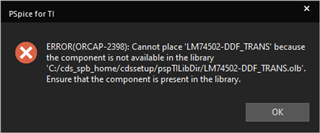

When trying to load symbol from library I get an error.
The file is present
Please help
/Michael
  • Hi Michael,
    Welcome to E2E!
    May be the model is not released to "Pspice for TI". Can you download from ti.com https://www.ti.com/product/LM74502#design-tools-simulation and try once.
    Rakesh
