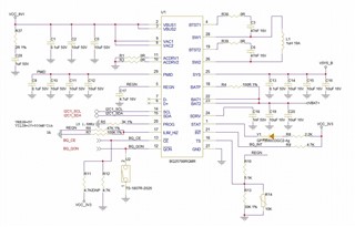

We have a 15V PV panel + 1s  battery charging application using the BQ25798 in BYPASS mode.
BQ25798 does not work when the following conditions apply:
First, the battery was dead, and second, the sun was rising slowly in the morning,and the voltage of the solar panel is slowly rising.
In this case, even if the solar panel energy is very large, the BQ25798 does not work,the PIN RGEN is 0V,and VSYS is 0V.At this time Re-plug the solar panel input power ,it can work.
I used BQ25798EVM BYPASS mode test, the same phenomenon.
