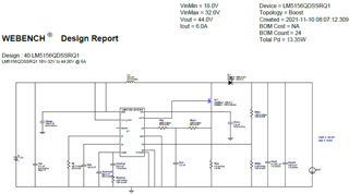

I have been tasked with testing someone else's design using the LM5156HPWPR chip and am having issues with delivering power at load. Smaller loads work as intended, but when I swap to the intended load it fails to deliver the output voltage and you can clearly hear clicking/switching coming from the board.
The designer seemed to very closely follow the design suggested by the WEBENCH tool, with the only significant differences I see being the addition of LED indicators.
I am fairly confident our supply is not the issue and while I have not gone over every trace I would broadly trust the designer's layout ability. I've familiarized myself with the chip and the datasheet and have not yet noticed any obvious errors. Any Input on the steps I could take isolating where the issue might be would be greatly appreciated!

  • Hi Marsh,
    The switch node (SW) refers to the point between inductor, output diode and FET.
    I marked it on the schematic:
    Vout is the same as Vload, this is correct.
    Niklas

  • Thanks for the links. looks like the expected duty cycle should be in the ballpark of 60%.
    As for the quick start tool, perhaps I am not using it correctly but I am not seeing any real change from the 4mΩ sense resistor we are using. As a sanity check, i compared our design with that which was provided by the the WEBENCH tool given an input voltage range of 18-32V, a nominal voltage of 28V, an output voltage of 44V, and a current of 6A. Everything looks good, with the sole difference I see being the indicator LED shown below.

    A notable difference I saw between webench schematic and the quickstart tool is the output capacitance.
    Webench seems to use 40uF, but I would recommend at least 100uF to higher stability and lower output voltage ripple.
    Ceramic capacitors also have higher DC bias derating, so the actual inductance at 44V output voltage may be lower.
    What is the output capacitance used in your design?
    And can you point out any other differences between your design and the webench schematic?

  • Thanks for the quick responses and for looking into this!
    I didn't recall the CS pin being particularly noisy but I can have another look in case that is an issue.
    As for the output stage, it looks like we already added a little extra capacitance but certainly not on the order you are talking. We can certainly look into improving the output capacitance.
    The only other difference I see (beyond the already mentioned LED indicators) is a TVS diode at the input. Though now that I am checking things again I see the input capacitance is a little lower than the 4.7uF recommended.

  • Hi Marsh,
    Thanks for the update.
    Input capacitance is of lower importance than output capacitance for a boost topology. As long as there are no drops on the input voltage signal, there should be no problem.
    Regarding output capacitance, please account for derating as mentioned before.
    The compensation network placed in the webench schematic should be stable for Cout of 100uF, but may not be ideal for 40uF or less effective capacitance.
    Please use the quickstart tool to visualize the bode plot stability for this. ( https://www.ti.com/tool/download/SNVC224 )
    We recommend a phase margin of 60 degree or more for a stable system.
    Niklas

  • sorry for the delay! it took a while to get parts in and then have time for more testing.
    i swapped the 3 ceramic 15uF caps in parallel with 3 aluminum 33uF caps and the circuit performed as expected! both output voltage and current looked great with the values we would expect.
    thanks for your help! we will move for a re-spin of the board now. we will keep our layout as close to the same as we can while making the capacitor adjustments and adding a couple more test points.
    any further input on recommended capacitors or any other tweaks before we re-spin would be quite welcome. thanks for your help in stepping through all of this!

  • Hi Marsh,
    I am glad to hear the behavior improved with larger capacitance.
    There are no other required chances I see right now. For the next revision, a general recommendation is to place some additional footprints for output caps, gate resistor and RC snubber circuit at the forwarding diode.
    This way additional fine-tuning can be performed much easier if necessary.
