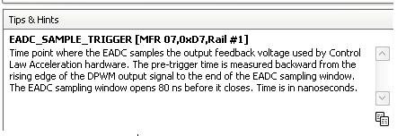

I believe that this tip within Power Designer that says that the EADC sampling window is 80 nsec duration isn't correct. Multiple other sources say that the sampling window duration is 32 nsec.
