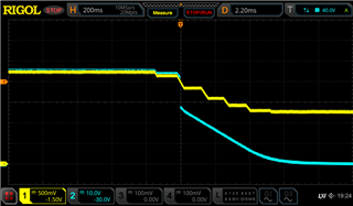

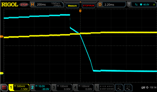

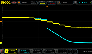

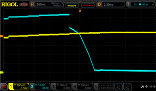

Hi.
We are using the TPS2493PWR for a hotswap circuit. The application voltage is set to 24V, with undervoltage enable at 18V and over voltage at 32V.
When we use the guide in the datasheet, we get the following values for R1, R2 and R3: 220k, 6.8k and 10k.
However when we are testing the design in the lab, we see that UVEN and OV actually triggers at 2V, instead of 1.25-1.35 stated in the datasheet.
This means that the opperating window is from 29V and upwards, which is too high for our application.
Is this an error in the datasheet, or is this an error in the  batch of TPS2493PWR we got?
