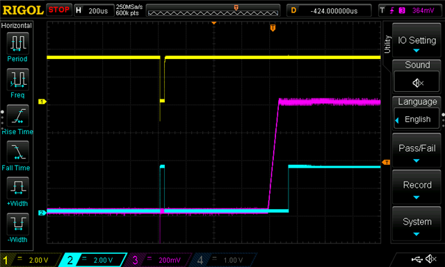

    Here is the plot:
    - I single trigger on VOUT1: which comes up as expected, but GPIO2 is turned on before VOUT1 is high. I have modified the json file to bring PGOOD out to GPIO6 for analysis, but PGOOD is always high. I have included the .json as a .txt file for you to look at:
    Note: It makes sense that GPIO2 would immediately go high, if PGOOD internally was always GOOD, so maybe there is a register that not set correctly. If you help me to first get PGOOD working properly (on GPIO6), we can progress from there.

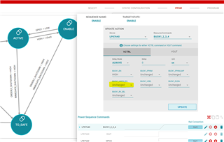

  • Hi Alleyn,
    I think issue is that you haven't enabled BUCKx_VMON bit when BUCK is enabled. This bit has to be set as well. And same bit has to be zeroed when shutting down. With this i expect GPIO2 will go high after BUCK is on valid window.
    Br, Jari
  • Hi Jari,
    Thanks for the reply, this has resolved the problem with GPIO2 on my first config. I will now develop and test the other configs. PGOOD also responds now.

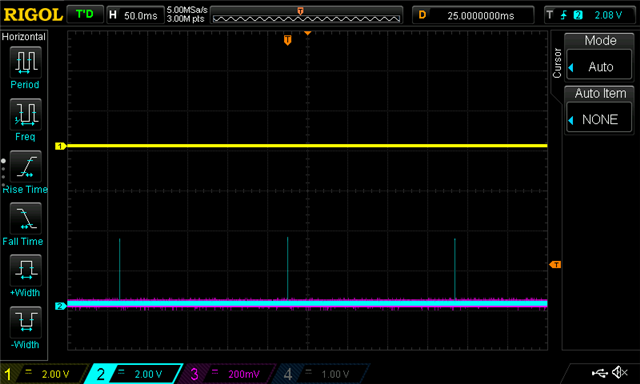

    I have another minor issue: see plot showing GPIO1 (1), GPIO2 (2) and VOUT (BUCK_1_2_3_4). I am getting spurious activity on the GPIOs, prior to the rails being enabled. You can see after I enable GPIO1 (offscreen), just before the VOUT starts to ramp. There is a 34us pulse on GPIO1 and GPIO2. These occur every ~210ms, and the pulses stop after VOUT has been enabled. Is there anything that can be causing this?

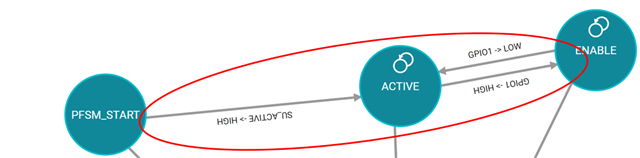

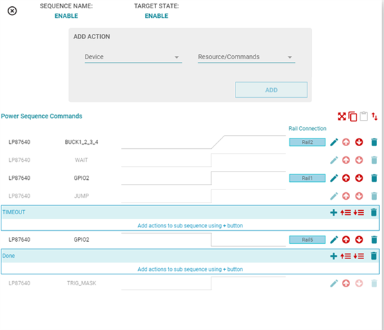

  • Hi Alleyn,
    Not sure what exactly is causing this behavior but we have identified some updates that should be done.
    For example, if you change the following triggers to normal instead of immediate.
    And update the Enable sequence with Jump instead of END as following.
    Let's see if you still get the same behavior.

  • Thanks Ishtiaque,
    I modified that but also change BUCK1_VMON_EN=LOW in the ACTIVE state when disabling BUCK1 before GPIO1 is set high. This seems to resolve the spurious toggling issue. BUCK1_VNMON_EN is only set high when I turn on the BUCK1 in the ENABLE state.
