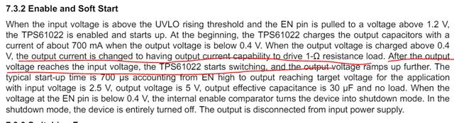

Regarding datasheet P.17 Figure 8-5, I have a question about Start-up Waveform
① There is a flat part of about 40μs during the rise of the Vout waveform.
Why is this? Is it the device specifications?
②In the Inductor current, the current drops at the same timing as the flat part of Vout. Why does it not level out and fall down?
tps61022_fig8-5.pdf
I appreciate your great help in advance.
Shinichi
  • Hi Shinichi,
    This is related to the start-up method of TPS61022.
    There are two modes during startup, when VOUT < VIN it is pre-charge mode, when VOUT > VIN, it is switching mode.
    The flat voltage caused by the mode change, there are some transition time during mode change.
    It is actually device's feature, and also related to the load, with different load the behavior will be a little different.
    Nathan
