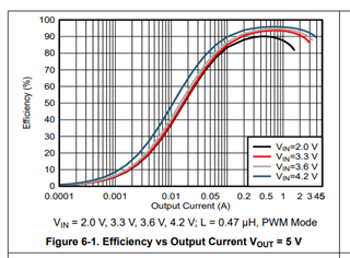

Hi team,
         I'm working on developing a booster circuit for an application and need some guidance. We require a booster that can accept an input voltage ranging from 2.2V to 4.2V and provide an output of at least 5V and 3A. Could share schematics and a Bill of Materials (BOM) that would meet these specifications?
Additionally, the datasheet (TPS61033-Q1) for a component I'm considering mentions that with a 4.2V input, the circuit can support up to 4A output. Can someone confirm if this is generally achievable with a suitable design, or are there specific considerations I should be aware of?
Thanks in advance for your help!
