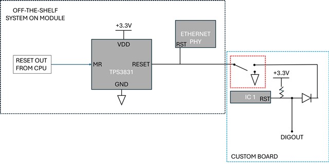

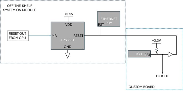

  • I have attached a simple schematic.
    We purchase an off-the-shelf SOM that has the CPU and Ethernet PHY. The RESET output of the TPS3831 is tied to the RST line of the Ethernet PHY, and also goes onto our custom board section via a connector.
    I can use DIGOUT to manually cause the the IC1 RST pin to go low, without causing the Ethernet PHY to reset.
    Now, I need to be able to reset the Ethernet PHY without resetting IC1.
    I think the only way I can do that is by causing the RESET output to go over its max current so the voltage drops out. I cannot use the MR pin, because that only goes low when the CPU reboots, and I don't want to reboot the CPU. Also, if MR does go low, I still want the RESET output to reset everything downstream of it.
    If I added logic like the following red box, then I can reset the Ethernet PHY without resetting IC1, but It would short the RESET line of the TPS3831 to ground. Is it safe to ground this pin for ~200 ms?
  • Hi Jason,
    Thank you for your detail explanation on your system requirements.
    I think there are two solutions. First one adding another switch that  removes RESET output from the ground, which can protect the TPS3831 is  since the RESET output will be floating when you need to reset ETHERNET PHY.
    The other solution is that we have 2 channels devices with separate RESET outputs, such as TPS3704, TPS3760, TPS3779, you can assert the reset depending on your requirements.
    I can assist you more on which supervisor would be better if you interested and can provide more details what voltage is needed for the rail, reset timing requirement, and functional safety is required or not?
