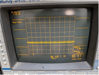

  • Dear Nathan,
    As an update the board failed in the same maner with the TPS61253A shortly after I posted the above.  I captured waveforms in the faulty state:
    SW:
    Vin:
    Vout:
    Cheers:
    Jeff
  • Hello Jeff,
    I'd estimate that on average it will occur after running for 8hours on a charger
    Do you mean that for each board, it will occur after running about 8 hours? I want to make sure that if this behavior will vary depending on the chip or not, if it occurs on each board or not.
    And more, I can't get a clear information from the waveforms, for example, what is VOUT VIN voltage? From the waveforms, only a line but not zero scale so I don't know what is voltage now.
    And it would be helpful if you can capture the waveforms at the moment when the device starts to behave abnormally. Maybe not easy but would helpful if you can.
    Thanks.

  • Dear Nathan,
    Thank you again for your help.  I'll do my best to address your questions, let me know if I miss anything.
    The 8 hours was just an average for brevity.  The longer answer is we've tested 6 boards, all have shown this behavior with the TPS61253A, on multiple occasional.  Sometimes the chip will maintain the appropriate 5V out for only 1 hour sometimes for over 12 hours.  Generally they fall out of spec after about 4-8 hours on a charger.  We've never seen any of the board's TPS61253A go out of spec if they are running solely off the battery. We charge the system at 5V, that input would come from a wall wart into the V_Charger rail in the above schematic.  Let me know if that's clear or if you think some additional details would be helpful.
    Sorry the waveforms weren't clearer, I had used the AC coupling to zoom in on the changes.  I can tell you consistently when the system is in spec Vin is 4.2V Vout is 5V.  When out of spec Vin is still around 4.2V and the Vout is following that closely, is just under 4.2V.   I'm not sure how to capture that transition, I suspect it's occurring on the order of a couple ms once per 4-8 hours, do you have any suggestions?  I'm open to getting new equipment within reason.
    Let me know if that sparks any ideas or if you have any additional questions.

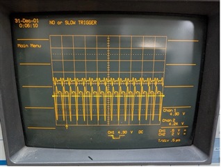

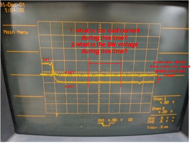

  • Dear Nathan,
    Thank you for those theories.  Does seem like some possibilities.  I have been working through the troubleshooting I can from them along with trying to capture some waveforms via your suggestion of using a trigger off the Vout, and have had some success. Thank you again for that suggestion.  Though as the error is sporadic I have only capture a couple errors:
    Here's the SW line channel 2, and the Vout on channel 1 with the trigger before the error/trigger:
    and after the error, which I think just shows the lower voltage.
    Here is Vin as compared to Vout when it falls:

  • Hi Jeff,
    From fig.3, it looks like, there is a inrush at VIN, VIN rise to about ~5V. I guess this is the moment when charging 5V starts, there are some inrush current at VIN.
    And more, the voltage drop between VIN and VOUT in fig.3 is about ~400mV (need to double check), it is larger than what I think. In pass-through mode, the voltage drop is caused by the inductor resistance (DCR) and the high-side FET resistance.
    And more, may I know your inductor DCR?
    For example, if the DCR is 40mohm, high-side FET resistance is 60ohm, 400mV voltage drop means there is 4A load current.
    Is it possible that the load current of TPS61253A becomes so large when the charging 5V starts? If that, it may stuck in pass-through due to the condition below.
    1. If the VOUT is soft shorted by something like a very large load current  (even higher than current limit), or shorted by a small resistance at VOUT node. It may be stuck in high-side FET on condition, looks like as same as pass-through mode. The device will not exit this condition until you remove the soft short.
    And more, could you please clarify the question in the figure below?
    Nathan
  • Dear Nathan,
    Thank you again for taking a look, and taking a look at the waveforms I was able to capture. I think the monochrome oscope I have makes it a little more difficult, but you essentially have the same interpretation I do, but with a couple corrections.  I’ve highlighted channel 1 and channel 2.  The values on the right box, refer to the reference cursor which is the dash dot line.  I had put it right at 4.2 V for channel 2 as I thought that was relevant but that made the offset different – the channel 1 vertical scale is 300mV above the channel2 scale.  So Vout (Ch1) and Vin (Ch2) are much closer. I make Vout and Vin to be close to the same value just under 4.2V:
    As to your questions on the graph.  I didn’t measure the SW voltage at the time, but from the previous figures which were capturing similar failures, I make the SW voltage to be a little bit under 4.2V as well.  I don’t have a measure of the load current independently, but Vout supplies a pair of resistors with an equivalent R of about 7Ohm, so unless there is a temporary short the load current should be about 700mA (max).  The current to the resistors are controlled by FETs that switch on and off to maintain temperatures.
    The other point to clarify is the spike evident in figure 3 doesn’t correspond to the charger being attached.  The charger has been attached for at least several minutes to an hour, this is the captures via the trigger during that running.
    The Inductor’s DCR is 26mOhm.  It’s PN: IHLP1212AEERR82M11 From Vishay Dale is that’s helpful.
    I think understand your theory about the Vout short, and the TPS61253A looking like it’s in pass through mode, but pinned.  I’ll see if I can find a short, but so far I haven’t seen other evidence. (The board isn’t heating up, I haven’t noticed large current draws.  Also this only happens when connected to a charger, so the short would have to be related to a charger being connected? )
    Do you have any suggestions on hunting for this possible soft short, or any other ideas? I’m trying to recapture that failure to double check, but so far it hasn’t happened today.
    Thank you again,
    Jeff
  • Hi Jeff,
    If VIN VOUT SW are all about ~4.2V, seems like the VOUT short or large load current is not the possible reason.
    I will make some test in our bench to see if it can be reappeared in our lab.
    By the way, do you know why VIN sometimes increase to as high as 5V suddenly? Do you mean that there is no action at this moment, but the VIN increase?
    Looks like this VIN increasing cause the problem. How about adding larger input capacitors of TPS61253A?
    Nathan
  • Hi Jeff,
    After discussion with design team, looks like it is because that the input voltage increases and decreases too fast for some internal comparator to operate normally.
    So maybe you need to find out why there is an abrupt change of input voltage and try to remove it. Or we recommend to add larger input capacitance so that the slew rate of input voltage could be slower.
    Nathan
