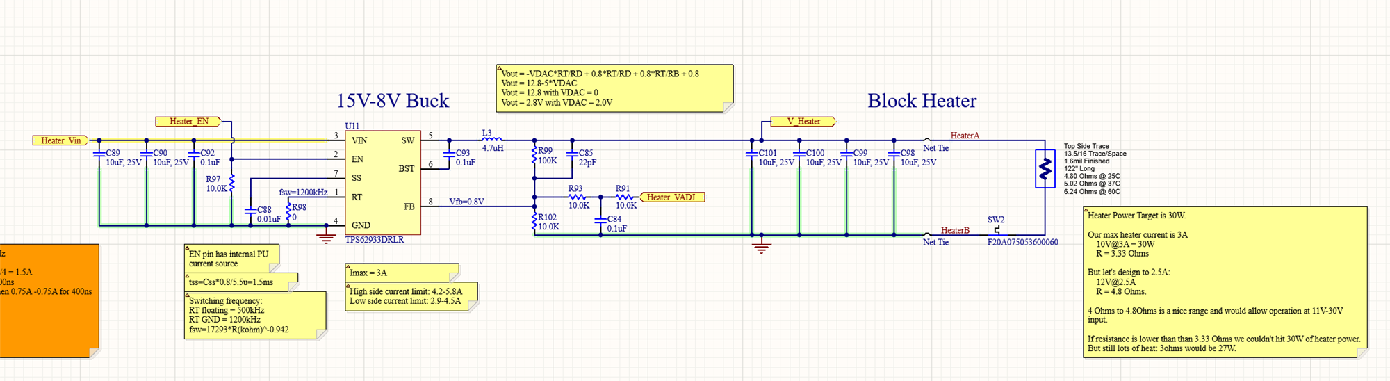

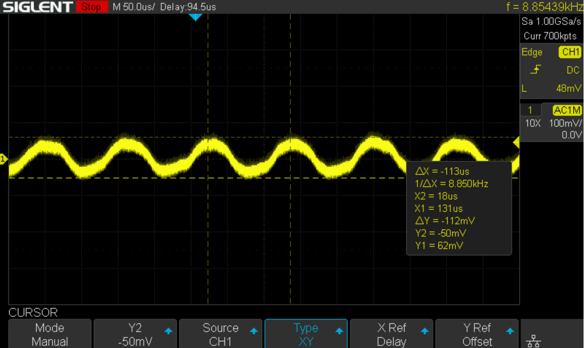

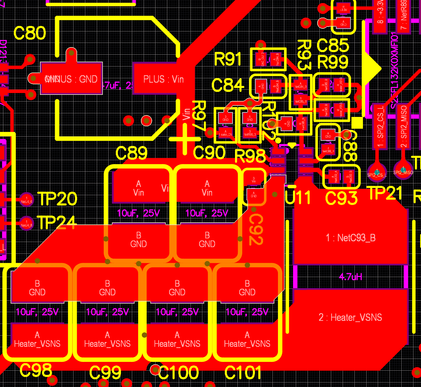

I'm using part TPS62933DRLR in a design of mine. Below is the schematic of the circuit. I have a purely resistive load that is pulling 0.1-2.5A. At the higher end of the load current, the buck converter produces audible ringing. Decreasing the output voltage and thus the output current reduces the volume of the audible ringing. The buck converter is switching at 1.2MHz and it looks like the spread spectrum works at 1.2MHz/128 = 9.375kHz. I am seeing that frequency on the input and output of the buck converter. Are there any ideas on why this frequency content is showing up? Insufficient input/output capacitance? The converter isn't stable? I have used other spread spectrum parts and never encountered this problem before.
Other items I've tried:
-increasing the feedforward cap (C85) lowers the AC amplitude of the ~9kHz ringing and thus the audible ringing, but decreases the buck converter output voltage
-increasing the switching frequency to 2MHz increases the low frequency ringing from 9 khz to ~14.5kHz
-removing R93 in the circuit below had no impact on the ringing
Schematic of circuit:
Voltage output of buck converter, AC coupled:
