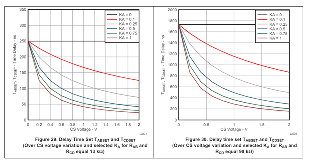

  • Hello Nitish,
    You might be able to use these characterization curves from the data sheet to try to set the timing.  I have put them below.
    For one case were you do need as much delay use an RAB of 13 Kohm.  Then adjust the KA ratio for the curve that is closest to what you need.
    For the leg LEG CD you would use 90 kohm and adjust the KA ratio to the curve that is closes to what you need.
    Mike
  • Hi Mike,
    I have already tried using these curves.  Setting RAB = 13k and RCD = 90k does not help since we need the same delay (120ns) for the AB and CD legs at full load, but vastly different delays for those legs at light load, 260ns for AB while need 700ns for CD.

    Timing equation in the data sheet should show how the delay varies with ADEL, DELCD and DEL AB.  I do understand that it is difficult to set the delay timing due to the different dV/dt at the switch nodes and it is a lot of trial an error.
    I did here one idea that you had that shows promise.  That is to adjust the switch node capacitance to change the tank frequency.  Since this is resonant energy it will not calculate as loss.  You might want to see if you make the switch node behaviors have similar dV/dt then you can use the same timing.

    I have discuss this with the IC design team and there is not a detailed block diagram that we can share with you.
    However the ADEL and ADELAB/CD pins program an internal current mirror.  The ADEL voltage is passed through an internal buffer to the ADELAB/CD pins.
    With this information you could characterize the turnon delays vs the voltage at the ADELAB/CD pins based on the ADEL voltage.
  • To add more clarity here, you can only sink current from DELCD pin to reduce the "effective" resistance, but not injecting current into the DELCD pin.
    Like Mike suggested, you can measure the DELCD pin voltage and observe the deadtime change to tune your active circuit.
    I don't recommend to touch ADEL pin since it is linked to other settings.
