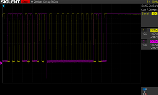

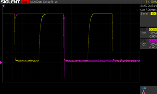

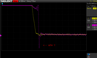

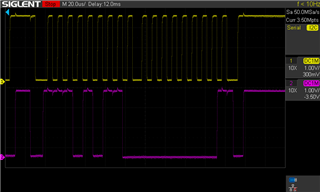

  • First I need to clarify that I was wrong stating that TPS63810 register read was working.  Register reads do not work for either 63810 or 63811 modules.
    Still, register writes do work for TPS63811EVM.  I captured some waveforms of TPS63811EVM.  The first attached shows a bigger picture.  Captures that follow are zoomed, particularly focused on the SDA line dropping to -2.0V (yes, negative) prior to the attempted read.  In the images:
    SCL - yellow
    SDA - purple
    and voltage range is ~ 0-5V.
    Not sure why the sharp negative voltage spike.
  • Hi  Brain,
    Good to hear.
    For spikes, it depend on you actual system, Such as a large parasitic inductor in your SDA cable or not suitable set-up for your test system. But, it is very sure that root cause of this spike is not device itself.
    Tao

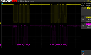

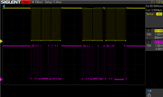

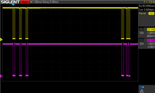

  • Tao,
    Ok, so I wired a logic level shifter (bob12009) for the I2C, though it isn't strictly necessary, swapped the 10k resistors for 8.2k and triggered on a soft Arduino reset rather than initial power on.  Seems the spikes were mostly due to triggering immediately after Arduino power on.  I modified the Arduino sketch to be a bit more verbose, added some missing return value checks, and cut vout enabled duration to 5ms so I could capture the entire sketch execution on a single screen.
    Everything works, but I still get 0 as a return value when reading VOUT1 register at the end of execution.  It should be readable, right?  I still don't understand why I get 0.
    waveforms shown:
    1. entire execution
    2. working register writes (early)
    3. disable vout (clear enable bit), select VOUT, requestFrom, check available, read
    4. reading VOUT resulting in 0
    5. Arduino serial monitor output (showing no errors for function returns)
    Any thoughts?

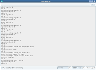

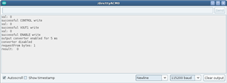

  • Hi Tao,
    I checked and it is set correctly.  As I mentioned above, I'm unable to read any registers not just VOUT1.  I added a simple function to loop through the registers and you can see each returns a read value of 0.
    amended code
    #include <Wire.h>
    #define ADDR 0x75     // TPS63811 I2C address
    #define CONTROL 0x01  // TPS63811 control register address
    #define STATUS 0x02   // TPS63811 status register address
    #define DEVID 0x03    // device ID register address
    #define VOUT1 0x04              // VOUT1 register address
    #define VOUT2 0x05              // VOUT2 register address
    #define VOUT1_RESET 0b0111100   // VOUT1 default bits
    #define VOUT2_RESET 0b1000010   // VOUT2 default bits
    #define SDA 20    // data line
    #define SCL 21    // clock
    #define DEBUG
    int val;
    uint8_t result = 0xFF;
    void wire_read(uint8_t reg)
      result = 0xFF;    // reset to error value
      Wire.beginTransmission(ADDR);
      Serial.print("select register ");
      Serial.println(reg, HEX);
      Wire.write(reg);              // select register
      val = Wire.endTransmission();
      Serial.print("val: ");
      Serial.println(val);
      if (val != 0)
        Serial.print("error selecting register ");
      else
        Serial.print("success selecting register ");
        val = Wire.requestFrom(ADDR, 1);
        Serial.print("requestFrom bytes: ");
        if (Wire.available() == 1)
          result = Wire.read();
      Serial.print("result: ");
      Serial.println(result, HEX);
    void setup()
      // int val;
      // uint8_t result = 0xFF;
      pinMode(7, OUTPUT);
      digitalWrite(7, HIGH);
      pinMode(8, OUTPUT);
      digitalWrite(8, HIGH);
      pinMode(10, OUTPUT);
      digitalWrite(10, HIGH);   // power on TPS63811
      Serial.begin(115200);
      delay(1000);
      Wire.begin();
      delay(1000);
      Wire.setClock(100000);
      delay(1000);
    #ifdef DEBUG
    wire_read(CONTROL);
    wire_read(STATUS);
    wire_read(DEVID);
    wire_read(VOUT1);
    wire_read(VOUT2);
    #endif
    ... (rest of code omitted)
    serial output
    I'm out of ideas for now :(
    I appreciate all your help.
    Brian

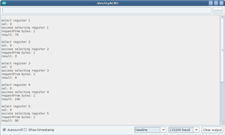

  • I revisited this earlier today and finally succeeded in reading the registers.  If I use 'endTransmission(false)' prior to reads it works.  The endTransmission() parameter defaults to true.  Setting the parameter false signals to not generate a STOP condition.  Setting the parameter false is only necessary for reads Thinking.  I'm not sure if this is the expected behavior but it is working... finally :)
    Latest code snippet and screenshot below.  *note - I disabled the Arduino internal pullups but had appropriate external pullups.
    #include <Wire.h>
    const uint8_t ADDR = 0x75;      // TPS6381x I2C address
    const uint8_t CONTROL = 0x01;   // TPS63811 control register address
    const uint8_t STATUS = 0x02;    // TPS63811 status register address
    const uint8_t DEVID = 0x03;     // device ID register address
    const uint8_t VOUT1 = 0x04;     // VOUT1 register address
    const uint8_t VOUT2 = 0x05;     // VOUT2 register address
    const uint8_t VOUT1_RESET = 0b0111100;    // VOUT1 default bits
    const uint8_t VOUT2_RESET = 0b1000010;    // VOUT2 default bits
    const uint8_t REG[6] = {0x01, 0x02, 0x03, 0x04, 0x05, '\0'};
    #define SDA 20
    #define SCL 21
    #define DEBUG
    uint8_t wire_read(uint8_t reg)
      int val = 0xFF;
      uint8_t result = 0xFF;          // set to error value
      Serial.println(reg);
      val = Wire.endTransmission(false);			// don't generate a STOP condition - this works :)
      if (val != 0)
      else
        val = Wire.requestFrom(117, 1);         // 0x75, 117
      return result;
    void setup()
      int val = 0xFF;
      //pinMode(7, OUTPUT);
      //digitalWrite(7, HIGH);
      delay(1000);
      Wire.begin();
      delay(1000);
      digitalWrite(SDA, 0);
      digitalWrite(SCL, 0);
    #ifdef DEBUG
      for (int i=0; i<6; i++)
        Serial.println();
        result = wire_read(REG[i]);
        delay(500);
        Serial.println(result);
    #endif
    rest of code omitted...
