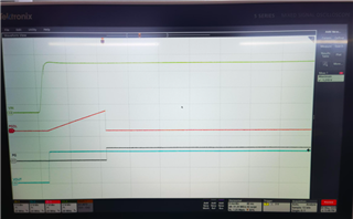

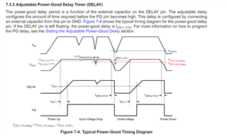

From the datasheet description, when the output is normal, the Delay will keep high, just like below picture shows:
But when I use the EVM to have a test, I find the Delay pin will pull low when it meet the rise up threshold(1.2V), that is a expected behavior for you? Thank you.

    What connections do you have on the DELAY pin -- do you have a capacitor populated, and if so, what value?
    Also, I can't tell by the image, is PGDL AC-coupled?

  • Hi Kelsey,
    Yes, I have a 10nF cap in the DELAY pin, the PGDL is the DC-coupled, and it seems that it will go to low in the normal condition, and the cap controller will pull it low, right?

  • Hi Kunyue,
    Feedback from the designer is that the behavior you're observing is expected. The delay capacitor is discharged and held in a discharged mode after it is used to implement the delay. This is done in preparation for the next "power bad" / undervoltage condition, so the delay cap starts from zero charge to implement the desired delay.
    The DELAY waveform in the datasheet is incorrect, and I've submitted a request to update it. Apologies for the confusion this error caused, hopefully this helps clarify.
