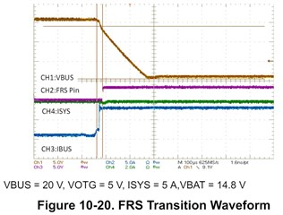

Hello Tiger,
A customer is considering using the BQ25723 as a backup power source for a system of consumer device.
We understand that FRS is a function that allows you to quickly switch between sink and source, and we hope that it can be used in this system.
Is there more information we have to provide?
MM
HI MM,
Figure 10-20 shows a FRS transition waveform. It is very quick in transition in the range of tens of microseconds. I would suggest you ordering a BQ25723EVM and try out its FRS function.

Hello Tiger,
We have already checked the waveforms in Figure 10-20 of the datasheet.
We also understood that I need to use EVM to check the behavior.
However, what does "Please contact factory for more detail information about FRS mode" written in the data sheet mean?
MM

We would like to confirm the functions of FRS.
(a) Does “CH2:FRS pin” in Figure 10-20 indicate OTG/VAP/FRS of Pin 5 ?
(b) Is the following procedure correct to use FRS?
1. Set the registers as described in the pin description.
”When OTG_VAP_MODE=1b and EN_FRS=1b, pulling high this pin can enable FRS mode in forward operation.”
2. Set OTGVoltage to the desired output voltage.
3. Detects VBUS power loss externally and asserts OTG/VAP/FRS(Pin 5) from 'L' to 'H'.
MM
YES.
Correct.
