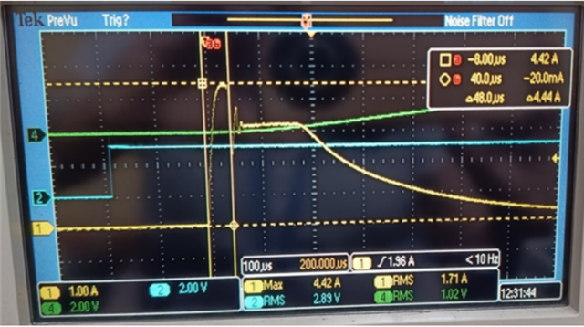

  • Hello Stephen
    This is the inrush current we are observing. As given the inrush current of 4.42 A after a duration of 50 us is getting current limited for 130 us. This happens during power on when the output capacitor is completely discharged.
    Can you tell about the effect of this in the LDO.
    Thank You
    Rifa S
  • Hi Rifa,
    From this oscilloscope plot, I think the LDO itself will be fine.  The inrush current does not exceed the bond wire fusing current with lots of margin to spare, the duration of the inrush is small (well under 1ms) so the junction temperature increase will be limited. The only item to investigate is your output voltage which is a system concern (not something that will hurt the LDO): I would make sure that Vout turns on monotonically, especially around the time that current limit is engaged.
    Stephen
