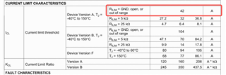

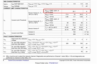

When R ILIM = GND, open, or out of range,its maximum current limit is a typical value in datasheet description.
I want to know the minimum current limit value when R ILIM = GND, open, or out of range.
  • Ling,
    The internal current limit is meant to be used as a failsafe mechanism where if the resistor on ILIM fails, there is a default current limit that protects the device. It should not be used as the primary current limit. We guarantee that the device will survive and that the current will limit around the typical value listed, however do not specify hard values.

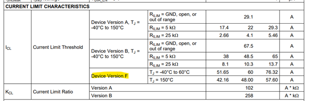

    If the current limit resistor cannot be used in the design, the recommendation is to use the F version of the device that has a set internal current limit and repurposes the ILIM pin as a general purpose fault pin. For the F version, we specify the min/max:
    TPS2HB16-Q1:
    To answer your questions below:
    1. The only way that this would be an issue is if there was significant impedance between ILIM and VBB. This is the normal path of the ILIM resistor. Anything else on the line would just be treated as open or out-of-range and the typical value would apply. With the F version, however, the pin is bonded differently and there would be no risk of interference.
    2. There is not explicit risk to the design- it's just the only thing we guarantee in this use case is that the high-side switch will shut down and not be damaged. I checked the backend data and we don't have minimum/maximum values (see #3)
    3. Not populating the ILIM pin on an A/B version of the device is considered a failure condition as the "open or out of range" on these devices is not referring to a deliberate design decision, but rather a fault situation where the resistor that is connected to ILIM is damaged/shorted.

    3. I prefer use version A/B,version F‘s limit current is too large.

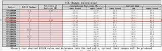

    First, we have the following tool for our HBxx/HAxx family which will show you the min/max current limits for all of the devices and also account for things like resistor tolerance. This might be useful for you.
    https://www.ti.com/tool/download/SLVRBG2

    If I use Rlimit=3.3K,it calculate limit current is 24.4~41.9A,but your datasheet show Rlimit must >5K.
    I want to know if I use Rlimit<5K,such as 3.3K,does it limit feature work normally?If yes, I want to know which limit value will be triggered,external resistance setting limit or internal limit?

    The Excel sheet does not actually check to see if the values are in range- it just feeds the values into a backend formula to calculate the accuracies. You are correct, however, in that the the current limit resistance must be between 5kOhm and 25kOhm as per the datasheet.
    To clarify, there is no functional risk with using the internal current limit. The only caveat here is that the only protection that we guarantee is that the device will shut off before any damage occurs to the high-side switch itself. As this feature is a failsafe mode, though, we do not specify a minimum/maximum current limit as it is not something we characterize.
