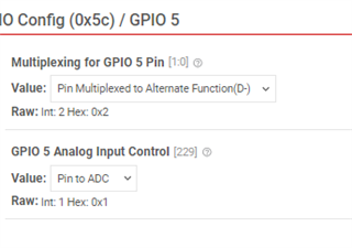

  • Hi Chris,
     I have more 2 questions about TPS25751D.
    1)GUI setting
       I have checked my TPS25751D setting, it was already set GPIO4/5 as D+/D- but they are GPIO(Not ADC).
       When GPIO4/5 are set as D+/D-(Multiplexing) and GPIO(the AnalogInputCTL ), does it not able to work DPDN detection?
    2)BC1.2 retry procedure
       The only way to retry BC1.2 is GAID or gaid CMD?
       GAID is hardreset,,, I cannot accept the VBUS discconnection.
       gaid is softreset, does it able to keep connecting VBUS ?
  • Hi Tomonori,
    1)GUI setting
    For BC1.2, the GPIOs should be set to D+/D- and set to GPIO, not ADC. I was changing some other settings when I took the picture above, and it should not be set to ADC for BC1.2. Sorry for the confusion there.
