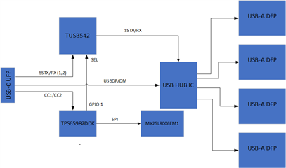

Hi guys,
I am designing an USB HUB and I am using TPS65987DDK but I am little bit confused about to configure TPS65987DDK. I know there is a tool to connect to the IC but I am confused how to connect with hardware. I've attached the diagram. I ll use FTDI4232 to flash the firmware to TPS65987. If I design like this, can the tool connect the TPS65987?
Best regards
  • HI Gorkem,
    The FTDI and MicroB is specific to the EVMs and is not necessary to add for customer designs. They are specific to the EVM and are for debug and flash purposes. They should not be included in an actual design.
    Correct, if you are using the EVMs, you can directly connect the EVM to a PC over the micro-B port, and the GUI tool can interface directly with the part.
    In a final implementation, you only need the TPS65987DDK and the SPI flash connected to it.

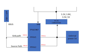

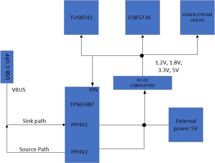

  • Dear Chris,
    Let me explain to you. I've attached 2 diagrams down there. One of is data other one is power.
    1-
    What are your system requirements for the USB-C port?
     It's an 4 port USB HUB and I want it to charge and transfer data when the UFP device has low battery.
    2-
    Is this a 5-V source only?
    There will be external power 5V. But it will not always on. If there is no external 5V input, the UFP device will supply power.
    3-
    Do you need a USB-C PD controller?
    I have used USB A PD controllers for DFP ports. For UFP, I used TPS65987DDK. These ports are USB 3.1.
    4-
    Are you usind TPS65987DDK  or TPS65987DDH? The schematic says DH, but the E2E says DK.
    I am using TPS65987DDK. Apologies for the schematics.
    Also I would like to share full schematics with you by message but I can't send you a message idk why.
    Best regards.
  • Hi Gorkem,
    Thanks for the info!
    All of the previous feedback still applies. I just labeled some of the port names on your block diagram to make things more clear.
    If you have any more questions about the schematic feedback please let me know.
    For any new questions, feel free to open a new E2E thread!
    Thanks and Regards,
    Chris
