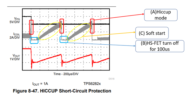

    Also please find the measurements in datasheet page-22
    Figure 8-47. HICCUP Short-Circuit Protection
    Figure 8-48. HICCUP Short-Circuit Protection (Zoom In)

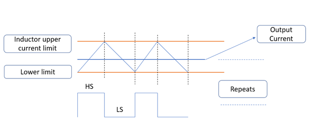

  • Hello Moheddin, thanks for the fast response but still the behavior is not clear to me. TPS62824 current output range is until 1 A but this ILIM  is very high (2.1 A ?) so i can not clearly understand its mechanism. Also figures are bit tricky to me: if i am not wrong Vout hiccups 0 to 1v and current hiccups between 0-2 A very fast in sawtooth form but it sounds like it is creating a very stressing case for my design instead of protection. Can you elaborate it a bit ?
  • Hello Bert,
    2.1A is the typical value and typical values are at TJ = 25 °C and VIN = 5 V.
    The min value is 1.7A, considering TJ = -40 °C to 125 °C, and VIN = 2.4 V to 5.5 V.
    ILIM is the peak inductor current value and average output current value will be further less as shown below.
    The switch current limit prevents the device from high inductor current and drawing excessive current from the battery or input rail. Due to internal propagation delay(typically 60ns), the AC peak current can exceed the static current limit during that time. If the inductor current reaches the threshold ILIM, the high-side MOSFET is turned off and the low-side MOSFET is turned on to ramp down the inductor current as shown in the figure. This repeats for  32 times(about 13μs)(A) and then the device turns off the high-side MOSFET(B) for about 100μs which allows the inductor current to decrease through the low-side MOSFET body diode and then restarts again with a soft start cycle(C). As long as the overload condition is present, the device hiccups that way, limiting the output power.
