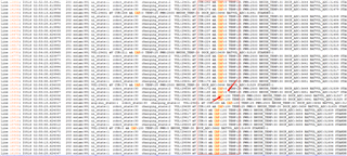

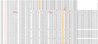

The battery pack we released shows that the SOC is 102% and 116% on the customer's host side, and the customer's host side only reads and writes to the BQ34Z100, but does not write;
ID2112.gg.csv
What is the cause of this?
    Was a ChemID match obtained using the GPCCHEM tool?
    Was a Learning cycle completed?
    Was the device calibrated?
    Can you share a log file of the error?
    Evan
  • Hi
    The learning process and calibration have been completed and the error log cannot be provided because the battery is in the user's hands
    0827.ID2112.gg.csv0827.0X1D48-report.zip
    That's all the information available at the moment
    If everything was configured correctly and a learning cycle was successfully completed, I will need a log file to further debug and to understand what the gauge is seeing and why it is outputting an inaccurate SOC.
    Evan
  • hi,
    This is a partially exceptional log, hopefully a useful clue, and that's all for now
    Can you provide this data in a excel format? So that I may graph the data.
    Evan
    Below are the logs related to the five batteries, the document is TXT

    7382.LOG.xlsxExcel was converted manually by me, hope it works for you
    Which parameter is state of charge under?
    cur  = current
    batvol_adc = voltage
    temp = temperature
    Correct?
    Regards.
    Evan
    VOL= voltage
    Everything else is true,The main unit only reads the voltage, current, State Of Charge, temperature of the battery,The other CAP is State Of Charge
    Thanks for clarifying, I have a couple questions for you.
    Are the cells being balanced?
    What is the battery chemistry?
    Also, with the log file sent the current is never negative, indicating it is never being discharged, this may be due to the gauge not being calibrated but this is probably part of the SOC issue.
    Evan
    cells are balanced,
    chemistry is lithium ternary,
    The customer used this battery for two months before this problem appeared and complained, it is certain that the battery was good at the beginning, and it took two months to have this problem
    This issue did not occur until 2 months into use?
    How many units was this seen on?
    Did the issue persist after a reset cmd was sent to the gauge?
    Evan
    The host only has read access to the battery, without any write permission, and the SOC has only two states, either 0% or 100%, 0% during charging, and 100% when fully charged,
    The battery is exported, and it basically can't be returned, so I don't know if the reset can be restored。
    A Reset cmd may solve your issue.
    Evan
