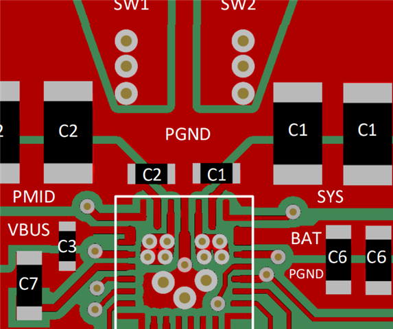

looking at the recommended PCB design, I'm not sure about the via count for connecting the inductor with SW1 & SW2, only 4 via...just don't seems right to me.
I plan to design a prototype PCB, and increase the via count from 4 to 10:
TI recommendation:
My design looks something like this:
The only thing I'm not so sure about is the GND connection at the IC top part. It is more narrow and far from the IC because of the 4 via supplement.
I do believe that 10 vias would be better than 4 regarding power losses and parasitic induction reduction.
Any thoughts? is this an over kill?
I would appreciate any comments.
Nir

  • Hello Nir,
    Yes, I would recommend making the GND connection wider and closer to the IC.
    I don't see any obvious issues using 10 vias, but 4 vias should be sufficient.
    Christian.
  • Hi Christian,
    I agree about the GND connection. It's better to have a smaller current loop at PMID & VSYS - so I'll remove the additional 4 vias for SW1 and SW2
    As you can see, I managed to squeeze 6 via for SW1 and SW2 beneath the IC, so between 4 to 10 vias, 6 would still be better than 4 with no other compromises.
    Thanks for your review
    Nir
