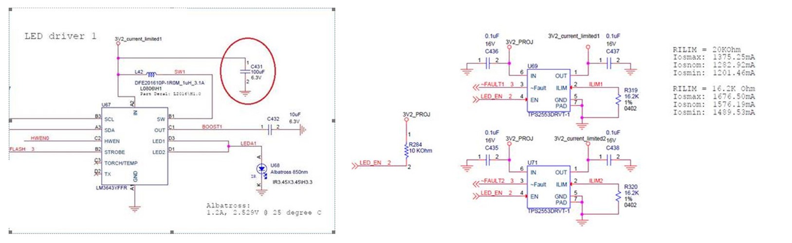

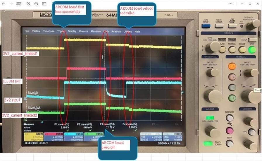

Please refer to the below scope waveform and the schematic.
When the system power-off, if the output cap(C431) does not fully discharged, the TPS2553-1 will go to Reverse-Voltage Protection mode and asserts the FAULT output (active-low). Is it right?
After the system power-off, my customer is doing the power reset and found the Fault pin still been asserted active-low.
They thinks the root cause since the Vin(3V2_PROJ) has not achieved 0V, or the EN pin has not less than 0.66V(EN pin VIL), so the TPS2553-1 power cycle or enable is toggled uncompleted. Is it right?
How to modify the schematic to fix the TPS2553-1 vout discharge uncompleted issue? please advise. Thanks!

    Is ILLUM_INT related to TPS2553-1 FAULT signal in any way?
    Are ~FAULT1 and ~FAULT2 nets pulled up to 3.2 V?
    I agree the power reset may not be recognized.  One quick test that can be done is to manually pull EN low after 3V2_PROJ returns high.  You should be able to take a jumper wire and connect the IC pin or associated test point to GND on your board.  The short only needs to be made for a few ms and we should see 3V2_current_limited1 return to its high state once the short is removed.
    If the above test is successful, you could try adding a cap from LED_EN to GND.  This will ensure the input voltage clears UVLO before EN reaches logic high.
    Eric
