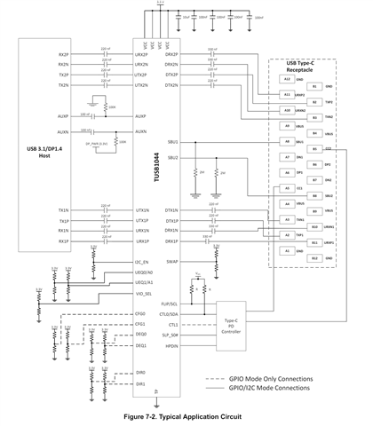

For the use of TUSB1044,
1. The typical RX design of AC coupling capacitor output and the principle of EVB are both 330nF, but the BOM of EVB(TUSB1044RNQEVM) is 220nF, please help confirm the specific size.
2, do not use DP function, AUX and SUB pins can be suspended?

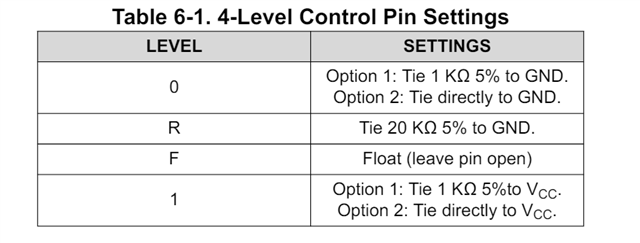

3. What is the default gain of CFG, UEQ and DEQ?
    Please see below application block diagram
    But you are right that URX1 and URX2 capacitors need to be 0.33uF.
    SBU pin can be floating, AUXP needs to be pulled to ground through 100k resistor, and AUXN needs to be pulled to 3.3V through 100k resistor.
    The default gain depends on external 4-level configuration of CFG, UEQ, and DEQ.
