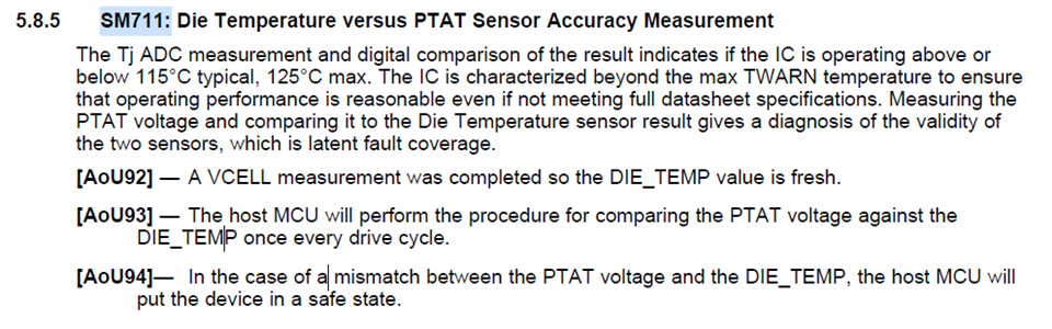

  • Hi Anthony
    Thank you for your answers.
    But the description of SM711 in safety manual as shown in below picture, it only detect the mismatch between the PTAT voltage and the DIE_TEMP. I think SM711 will not reports if the IC is operating above or below 115C or 125C. Or there may be some other way to report the fault if the IC is operating above or below 115C or 125C.
  • Yes Zizhen,
    When the test fails, it is in an indication of deviation from measuring the temperature. This is where it is to user design descretion how to much variation you are allowing in your system.
    Anthony Pham
