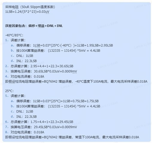

Hi team, Customer want to calculate the sample current accuracy, the calculation result is 0.018A and the actual error is 200-300mA at 100A.
Could you help to check the if the calculation method is right?  they use CC2 and CC3.  the calculation process is as follow.
  • Hello Jingguo,
    I do not speak Chinese. So it is hard to know exactly what is being done here. Can you please translate this?
    However, I do notice they seem to have a 50-uOhm sense resistor. 1-LSB is ~7.6-uV. Offset error is 1LSB, so 7.6-uV/50-uOhm = 0.152-A. So even if there were to be no current, it is possible to read a value between +/- 152-mA.
    Additionally, this is the resolution of the current measurement (152-mA). So the current would only change in 152-mA steps.
    If they take a log of the current, is this the case? Using CC3 should be able to filter out some of the offset noise.
