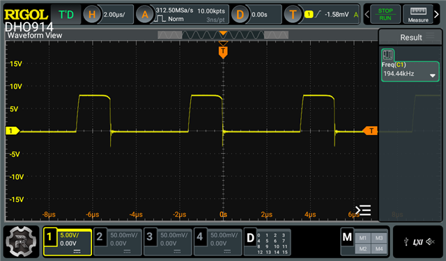

I am trying to drive two led in serie ILed.fs = 150mA with a PWM input at 70%@194MHz.

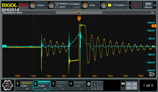

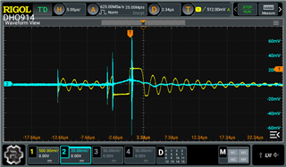

Here is a picture of Vout (Vin@7.3V) probeX10. Vout is a 5.3V and should be at 6.4V.
ILed is measured between TP4 and TP6 see shematic below. The value measured is extremely low.

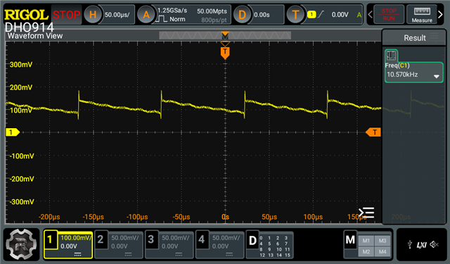

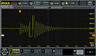

Here is a first picture of the signal ILed:
A a second picture with a zoom :

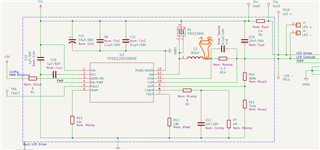

Here is a picture of the schematic :

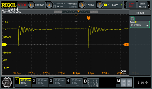

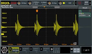

    Here is a picture of SW pin when Vin is at 12V (probeX10). The frequency of the signal is 10.5kHz.
    When you do this measurement, do you connect the LED load? If yes, then please provide your LED I-V curve or part number for me to check. Thanks.

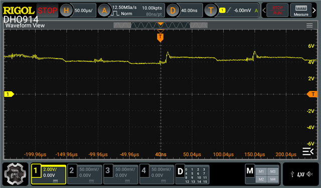

    I have made the modification on the board to make the new test. I have replaced C13 by 1uF electrolitic capacitor I have no MLCC in stock and no 1nF. I will replace them asap.
    I measure 5.5V on Vout when the LED board is connected.

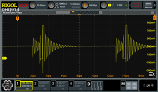

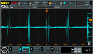

    Here are several pictures of SW (Yellow curve).

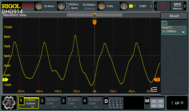

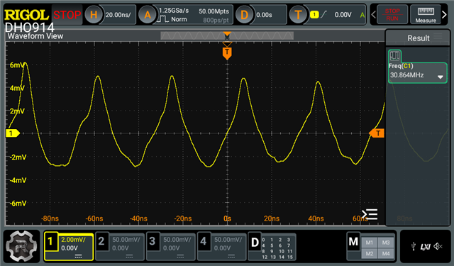

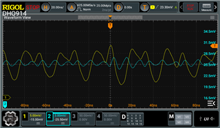

    I have removed electrolytic capacitor, it was replaced by 2.2uF MLCC for the test. Vled is still at 5.5V.
    This is SW :
    I did not measure the inductor current. How do you do that. Is it just by scoping the inductor ?
    Yes. You can solder the inductor to the board with a wire and measure the current through the wire with a current probe.

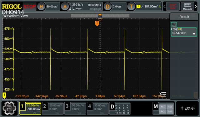

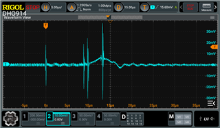

     I do not have current probe. To measure the current of the inductor, I put a 1ohm resistor in serie between L3 and R14 and I scope the voltage of the resistor. I do not have less than 1 ohm in stock. I will replace this by 1mOhm asap.
    This is I inductor wave form:
    SW with I inductor :
