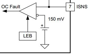

Q3: What is the OCP response time? Previously, TI mentioned that the voltage drop across the shunt resistor will be detected immediately by the internal comparator if it exceeds 150mV and the response time will not be particularly long. Do you understand that the voltage drop across the shunt resistor exceeds 75ns of the TBLNK listed below?

    Q3: As you mentioned, the OC has a blanking time at the beginning of each cycle to avoid false triggering due to diode reverse recovery.
    Regarding the delay between reaching the voltage threshold at ISNS pin and shutdown of the gate signal:
    There is an internal delay of 25ns typical.

    You mentioned there is internal delay of 25ns typical. And the datasheet specifies TBLNK is 75ns typical. So does this mean it takes totally 25ns + 75ns = 100ns?

    Q3: exactly. the 25ns would need to be added to the 75ns blanking time if OCP threshold is reached directly after turn-on of the MOSFET.
    Please note that the 25ns delay is the typical value, so there might be small variances from device to device.
