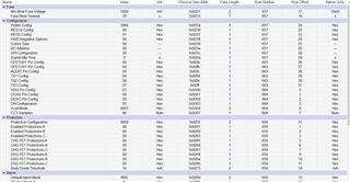

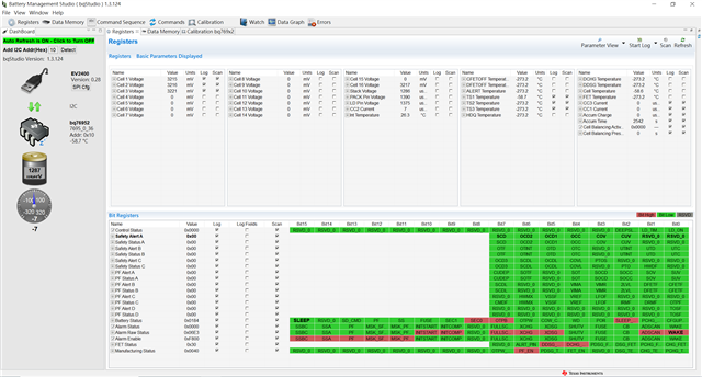

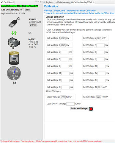

  • Hi Luis:
    Just can connect in bqStudio.
    But i find few problem.
    First is the TS3 keep in -253oC and i sure using the right B(25℃/85℃) 3435K NTC(TDK-NTCG103JF103FT1),
    and i try to cal it the studio said out of range, how should i start the debug?Is that case by a parallel 10nF CAP?
    And i can't charge or de-charge the pack even charge in 1A and de-charge in 4A,can help for check is the data had any problem?

  • Hello Minki,
    You must enable the thermistors in the registers. TS3 is disabled in your settings.
    FET_EN is also disabled, this means that the DSG/CHG FETs would not turn on. The following application note may be useful:

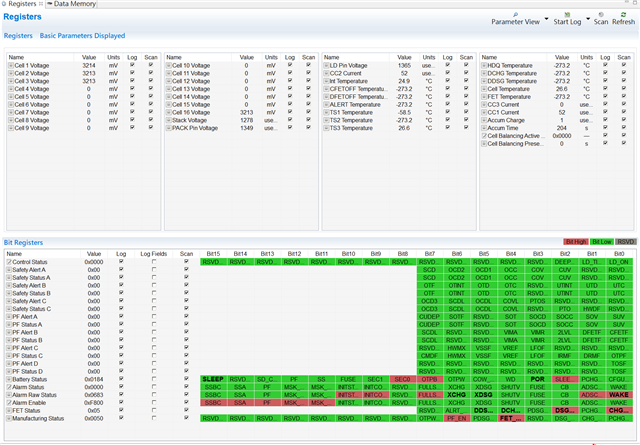

  • Dear Luis ,
    Thank for the app note but after setting the TS3 to cell temperature and FET_EN still not working
    And i found the the CP1 only about 15V now
    Please help for checking again the setting

  • Hello Minki,
    Looking at the image you shared, it looks like the part is working correctly. TS3 is measuring ~26degC and FET_EN is enabled, which shows that the DSG and CHG FETs are ON.
    The battery voltage seems to be ~12-V, so I'd expect CP1 to be ~11-V above that, so roughly 23-V or so. Is that not the case?
    Do you have a schematic for your design?

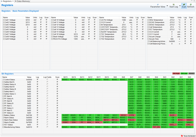

    Case 1:
    Connect the battery pack,only program Vcell mode to 0x8007,TS1 to 0x00,TS3 to 0x07,protect config to 0x2FET option to 0x1D
    and CC Gain to 0.145.The CP1 will have 23V, but after send out the FET-ENABLE command the the CP1 will drop to 15.1V
    Case 2:
    Connect the battery pack,only config CC Gain to 0.145,TS1 to 0x00,TS3 to 0x07,Protection config to 0x00,FET option to 0x1d.Mfg state init to 0x50,After config those the CP1 only had 15.1V(Checked Chg pump control is 0x01)
    Case 3:
    1.Connect the battery,open studio
    2.Measure CP1 23.4V,CHG12,722V,DSG 9.5V
    3.Config Vcell mode to to 0x8007,CP1,CHG and DSG same voltage
    4.Config TS1 to 0x00,TS3 to 0x07,CP1,CHG and DSG same voltage
    5.Config Protection Configuration to 0x00,CHG and DSG same voltage
    6.Config FET option to 0X1D,CHG and DSG same voltage
    7.Config Mfg state init to 0x50,After config those the CP1 only had 15.1V(Checked Chg pump control is 0x01)
    8.Config Mfg state init to 0x00,After config those the CP1 back to 23.4V,
    9.Config Mfg state init to 0x40,CP1 keep 23.4V,
    10.Config Mfg state init to 0x10,CP1 drop to 15.2V
    It seem case by some config error?Some error bit i didn't clear?Of the circuit MOSFET config problem?

    Other addition test,Config Mfg state init to 0x10,CP1 drop to 15.2V,CHG had 13.892V and DSG had 13.038V
    Turn on the ELOAD at 10mA,CHG will drop to 12.1V and DSG will drop to 8.791V,V pack drop near zero,
    Stop the ELOAD,CHG had back to 13.82V and DSG had 13.038V.
    So .... it is the MOSFET control HW problem?

  • Dear Lusi:
    And do you know what happen on this error?
  • Hello Minki,
    If the CP1 voltage is dropping from ~23-V to ~15-V, it sounds to me that the charge-pump may be getting overloaded somehow.
    As a quick test, I would suggest to remove R9 and R10 and see if the voltage of the CP1 capacitor is still dropping that much. The charge-pump is only able to handle ~40-uA of load current before its drive voltage begins to drop.
    I do not believe the issue is due to the software.

  • Hello Minki,
    This error may happen if CRC is enabled (When bqStudio is open for I2C withour CRC) or if there is a communication error.
    I believe it may be because Auto Refresh is ON. You should disable the Auto Refresh of bqStudio and try this again!
