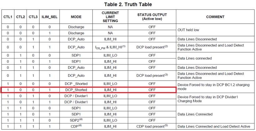

Does below setting DCP_shorted mode, can only enable BC1.2 but diable apple divider mode? thanks!
Hi Jeff,
When TPS2546 is set to the circled config, the DCP scheme is set to only DCP BC1.2 charging scheme, it will not advertise Divider1 or Divider2 charging scheme.
