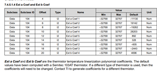

We’re developing a temperature polynomial curve for use with BQ27427 and NTC. I had a few questions I couldn’t answer from the relevant documents.
  1. When the BQ27427 reads the NTC, it seems to pull the NTC up for around 125ms every second. I’ve seen typical pull-up values of 8.45k(from  SLUA398) and 21k(for BQ34Z100-G1), what does BQ27427 use?
  2. Is the NTC ADC reference for BQ27427 the internally regulated VDD, 1.8V?
  3. Is SLUA398.pdf and corresponding ZIP file the correct reference document for computing a new NTC curve for BQ27427?
  4. How do I map the values from the SLUA398 Excel solver to the BQ27427 registers? For example:
    1. SLUA398 Excel: Polynomials: A0, A1, A2, A3, Min A/D Max Temp
    2. BQ27427 TRM: “Ext a Coef 1-5”, “Ext b Coef 1-4”
  5. Is there a function that takes in ADC counts and Polynomial coefficients and computes temperature that we could use for testing?

    The typical pull up should be 10k, and typically this is to 1.8V. For the thermistor coefficients, you can refer to section 7.4.5.1.4 Ext a Coef and Ext b Coef from the bq27427 TRM.
    Jonny.
    How do we map the outputs of SLUA398's excel calculator(A0, A1, A2, A3, Min A/D, Max Temp) to those you've highlighted in bold? The excel calculator only produces one set of coefficients, do we need an additional set of B coefficients? There's a different number of A-coefficients between SLUA398 and the BQ27427 registers, if we need to zero one of the registers, do you know which one it is?

  • Thanks Jonny! I've been able to build a parameterized curve fitter that looks pretty close for my application. But before I loaded my fuel gauge, I decided to try and reproduce the original coefficients using the Analysis_Custom_External_Thermistor_Coeff_NewConfig_20111111.xlsx, and it just doesn't line up. When I read them from the BQ27427 I get the expected values in the TRM. A few notes:
    1. The original spreadsheet claims to be for an NTC103AT, but specs Beta=3900K, while NTC103AT has Beta=3435K, so the resistance values in the spreadsheet seem to be for something else.
    2. When I replace the Temp/Resistance table with that of NTC103AT, and replace the R1 PU with 18K, the error curve is off about 15C.
    3. If I follow Max Naumov's instructions to adjust VRef from 1.8V to 2.5V, it's much closer, but there's still a systemic bias that any curve-fitter should've handled.
    Is there any chance you might have the tool used to create the original coefficients for the BQ27427? I'm just having a lot of trouble reproducing these results, and I know getting the temperature correct is important for Impedance Track's OCV measurements aligned.
