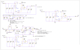

At this point I am concerned that there is something wrong with my design or I have a batch of bad parts.  I have attached the schematic page for the 5V0_A and 5V0_D supplies, as well as the layout used.
The 3V3 and 7V2 layout is a mirror of the 5V0_A layout.  Any ideas why I would be having failures?

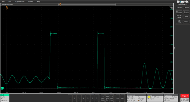

  • Here is a high frequency probe of GND:SW of the 5V0_D circuit running @ 32V in.  I don't have the 5V0_A circuit currently populated, but the other rails (3V3, 7V2) look similar to this, only a little over/undershoot.

  • What about pin to pin? I dont see an issue with your schematic and layout. Try adding more bulk capacitance on VIN. Do the other rails fail if the input voltage goes up to 24V?
    Ben
  • Problem found.  I installed another LM63625 and the switching node had severe over / undershoot.  After some more troubleshooting I pulled off the inductor and measured with LCR meter, LCR meter was giving inconsistent and unbelievable readings.  Replaced with a new inductor, waveform is OK, unit now operates at 32V.  There is no visible external damage to the inductor, but it is highly likely that the core has an internal crack/flaw.
