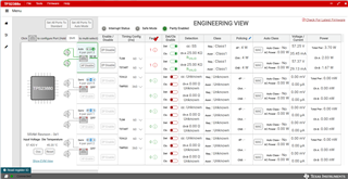

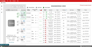

We are using the TPS23880 in automatic mode and although it correctly classifies various PD loads we are getting the ports turning off before it reaches the appropriate limits, specifically for Class 1 and 2. This is tested using the TPS23880 on our own product, a TPS2375EVM as the load and with an electronic load on the output. Power was taken from the TPS23880 GUI. For Class 1 our eLoad reached 2.5W, with GUI displaying 3.7W at which point it cut off with a PCUT exceeded error. For Class 2 the eLoad was 5.5W and the GUI display was 6.83W. Error again was PCUT exceeded. For other classes the output power seemed to be just about ok, although cut off was very close to the limits in most cases.
I'm using latest available firmware and would have expected the results to err on the high side rather than the low side.

  • Hi Mike,
    Can you confirm the PCUT thresholds using the GUI? Your expectation would be correct, the accuracy error is a positive error gaurenteeing the lower threshold. What SRAM version are you using?
    Brandon
  • Hi, Attached a couple of screenshots from the GUI. This is at the point where the power draw is about to exceed the limit (Class 1 and Class 2 here). The device in this case is programmed by the GUI but I assume it'll be using the latest version of firmware. Let me know if there's anything else I can provide. The PD is a TPS2375EVM, output is connected to an Electronic load.

  • Hi Mike,
    Let me see if I can reproduce this from my end. I ordered a new EVM to test on my side. Please give me a couple days to recieve new EVM and reproduce.
    Can you show me the GUI screen after the load is drawn above the threshold? Do it not shutoff the port? What is the behavior?
    Also, your operating voltage is slightly above 57V, can you reduce your power supply to 52V and see if issue persists. 57V is the maximum operating voltage within specification for PoE.

  • Hi, So at 52V input the results are more in-line with my expectations. I've attached a couple of images from the GUI, just before it drops out. However also of note is that this was done with a bench supply and when I set the bench supply to 57V the results were also similarly acceptable. I suspect the stability of the PSU may be the main factor here. The PSU we normally use is a 'lump-in-cord' style with 100W capability. It may be that at low loads the voltage isn't particularly stable. I'll do a bit more probing on the unit before we close this off, but looks like that's potentially the cause.
