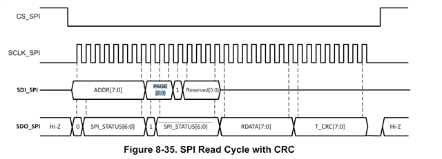

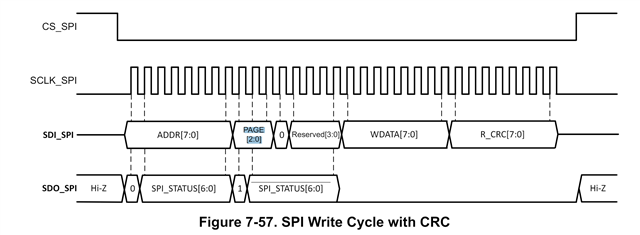

  • Another issue is that when I access the register of PMIC through SPI, the offset address of the register is single byte.
    How should I configure an address greater than 1 byte such as 0x409?
    The 4 in "0x409" represents page no is SPI communication protocol as shown below from DS.
    You did not mentioned whether you are using GUI of EVM or SoC software. I am not familiar with application software if it is the case. This depends on how the page number has been taken care in software interface.
    BR,
    Ishtiaque
