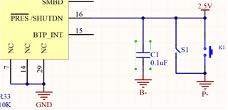

I have a few questions about the application of the shutdown function.As shown in the figure, S1 is a self-locking switch, and K1 is a reset switch.
1. If the battery is in shutdown mode, can the battery be activated after closing S1? Will disconnecting S1 again enter shutdown? Can I exit shutdown after pressing K1 for another 1 second?
2. When the battery is in normal mode, can I enter shutdown mode after pressing K1 for 1 second? Can I exit shutdown mode by pressing K1 again for 1 second?
  • Hi Sunrain,

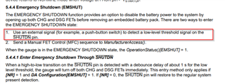

    If a high to low transition is seen from the pin with a debounce delay of 1s, then the gauge should be able to enter and exit shutdown mode.
    Below is more information on how to enter and exit shutdown from the SHUTDN pin:
