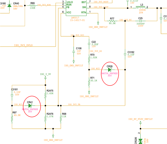

Hi TI experts,
I have questions for below LM5017 circuit.
1. CR28: initially the FB node is biased through CR28 to be higher than Vref, then FB node voltage drops lower than Vref after C22 is charged. At which point the switching starts?
If it's right at FB drops lower than Vref, how the smooth soft start can be achieved?
2. What's the purpose of CR41 in below schematic?
