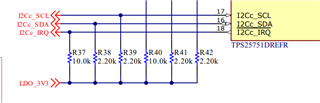

TPS25751D pin18 Datasheet mention NOT connect to GND.
However, reference design PMP41083 did connected to GND.
Could you help clarify how should customer handle TPS25751D Pin 18 I2Cc_IRQ when unused?
Thanks and Best Regards,
Will
  • Hi Will,
    Thank you for reaching out!
    Apologies for the confusion here.
    If unused, pin 18 should be tied to LDO_3V3 via pull-up resistor. There are instances where unexpected behavior may occur if tied to GND.
    You may also refer to the schematics in the TPS25751 EVM User Guide
    Please let me know if you have additional questions/concerns.
