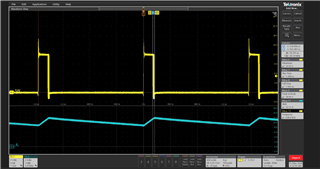

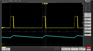

I am doing Jitter Measurment for SW Node-
Here is the setup information-
VIN-12V
Vout-1V
Iout- 10A
BW-20Mhz,1GHZ
Waveform capture in infinite persistence Mode of scope
i have attached the waveform
BW-1Ghz
BW-20Mhz
How to diffrentiate in b//w ON TIME JITTER AND FREQUENCY JITTER from above waveform?
I am getting arround 55ns & 29.291ns jitter with Diffrent Bandwidth
How to corealte these result with datasheet?
