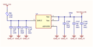

We have an application with LMS1585AIS-3.3/NOPB supplying some of the sensitive circuits. Below is the schematics.
(i) currently we are using ceramic capacitors at both Input & Vout pins. Is any change required for these caps?
(ii) What will be the measured ripple for this IC? We have a requirement for max ripple to be <30mV at 3.3V output. Is any change required to achieve it?

    This device is an old legacy device for which we have very limited documentation, and the datasheet also has very limited information. It's very unlikely that it will meet your tight requirement of 0.9% (I'm guessing that you mean including transients). My suggestion is to look towards the TPS7A57 because it can for sure meet your requirement and you can use MLCC for CIN and COUT.
    Nick

    In datasheet page 5 Electrical characteristics, RMS output noise is given as 0.003% of Vout. For 3.3V, it will be 0.099mV. Can this be considered as max noise/ripple?
    If not, can you pls share how to calculate max ripple of this IC?
  • Hi Nadini,
    "Ripple" is commonly used as a catch-all term that includes noise, ripple from the input supply that is attenuated by PSRR, and overshoot/undershoot from load/line transients. I'm not a fan of this terminology because (as maybe you are seeing now) it is not clear what is meant by "ripple" if that is the only requirement.
    The noise spec is only in the range 10Hz to 10kHz, which is not even the standard 10Hz to 100kHz range, and so there will certainly be more noise than the 0.003%VOUT listed in the noise spec. This is a major drawback of using these quite old legacy devices that are poorly specified - there is basically no data in the datasheet besides the EC specs, which are all only at specific conditions. With that said, I highly doubt that there will be greater than 30mV of ripple just from noise. It would be much closer to single-digit mVRMS at the most. Assuming that the requirement for "ripple" also includes load/line transients, the noise is probably the least of your worries because these old devices often do not have very good transient performance, and even many modern devices will struggle to meet 0.9% tolerance when transients are included.

    Got it. How can I help then? We don't have an EVM that fits the pinout of this device but I could probably make something work on an EVM that we do have. I'm not sure how much I can help besides doing some load transients, but I suspect that they would just show that the device will not meet a 30mV tolerance with transients included.
